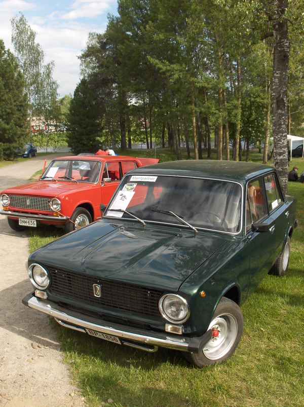

Ainoana suomessa Lada 2101 V6

Siinä yksi kuva lisää. :oPilt

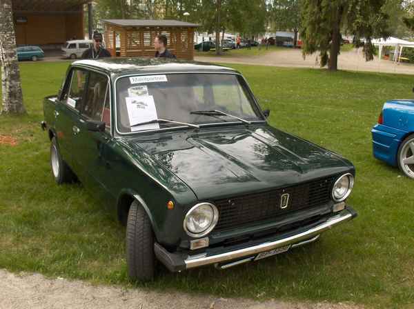

Tuplaputket...

yes, add pics but 640x480!
what engine? what gearbox?

Engine is from Ford Capri volume 2xxx litres and gearbox from Ford Granada type-9 5-speed.
Rearaxel is from lada 2105 3.9:1 but I think that I must change it maybe volvo“s axel. 3.9:1 is too slow to V6 engine, maybe 3.3:1 or 3.5:1 is much better and gives more topspeed.
It took 2.5 years to build this car and took lot of bood, sweat and 5000?
