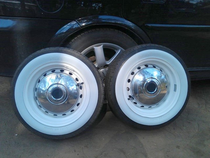

Damned. :( I restored my rims and have the same Atlas white walls as in yhe picture for 13 inches. I went to Vianor near airport and when they test a bit the loss of pressure betweeen 2.5 and 2 the white walls go away. The guy told me that they will get out of the wheel when driving. I just restored my rims for 76 euros and another 70 for white walls. Dont know what to do. Anyone has an idea?

Well, my whitewalls havent sliped away so far. Though, i've only driven them at 90kmph for about 40km and more at city speeds but doesn't really matter. Survived brake test and suspension test at inspection as well.
Currently running tubeless at 2.1 and haven't spotted any leakage yet either. 2101 rims if i'm not mistaken:
Did they use soap when mounting whitewalls? Manual that came with portawalls suggested not to: http://www.portawallshop.com/Thank%20yo ... rchase.pdf
Maybe beginners luck, but i had no problems, unfortunately i have little expereience and can't help out further.

I've driven for about 1000km or more with my whitewalls. Half of it on highways. They do need some adjusting every once and a while, but that's the price you've got to pay for this kind of alternative luxury.

The rims were freshly restored. Vianor guy advised to grind the rim in the inner part since the walls might be slipping because of the fresh paint and use of soap.. But after restoring them I don't feel much like grinding it (humidity, rust etc..)

You could always use glue between tire and whitewall and/or whitewall and rim.

don't grind. try to dry off the soap?
